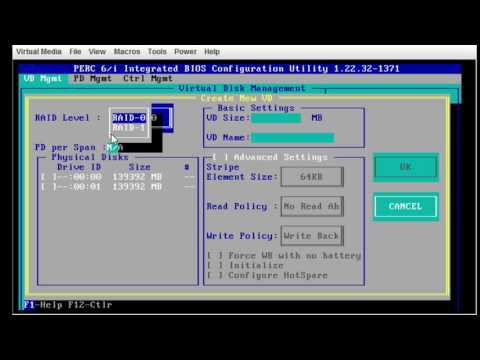

    I have just started on setting up the Dell R710 server, a bit later than planned but the Dell R710 does not see the 4 x 2TB hard drives in it. I believe it needs a RAID controller, but I am unsure how to proceed. I have a 4 x sata backplane. I have a cable already plugged in the backplane but I believe it to be a SAS and not Sata. I would appreciate any thoughts, I appreciate any help as I know this forum is mainly about Plex and that is the reason for doing this server/Linux project.
    Depending on your hardware, maybe you are just missing a driver/module?
    Edit: Judging by https://dell.com/downloads/global/products/pedge/en/server-poweredge-r710-tech-guidebook.pdf the server have a raid controller included, or am I wrong?
    Maybe this helps:

    Having done what you have with the HP systems, this should not be much different.
    The Dell specs for this model are here https://www.dell.com/downloads/global/products/pedge/r710-spec-sheet.pdf . This shows Linux is supported.
    I have the most success when creating a Live USB stick to boot from. The Fedora Live USB can also be used to install with. This USB will be dedicated to this task.
    The 'trick' here is to install the OS on the main 'boot drive'. This drive is not part of the raid set. The BIOS is pointed to this device to boot from.
    After having completed all OS installation and updates, restart the unit and enter the BIOS again.
    This is now a decision point for you. The type RAID you select here will determine how easily you can expand later. If you create a static-provisioned RAID volume, if the controller supports this, you will need upgrade all drives to their newer (larger) size before being able to utilize any of the newly added space. If, however, you create a LV-provisioned (storage pool) RAID volume, as you replace and regenerate the parity for each drive, you will be able to utilize the new space incrementally.
    Returning to your OP, I would first configure the controller BIOS for JBOD (Just a Bunch Of Disks) or leave the controller as 'passthrough' (flat) disk controller. Verify stable operation between OS and the one drive you will use as the OS drive.
