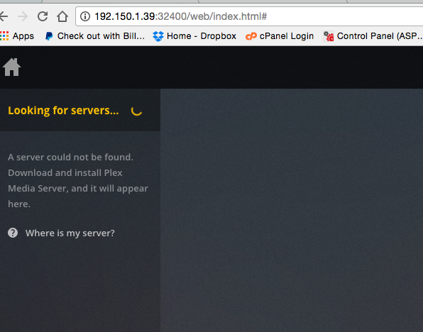

Help!!! I have been spending numerous hours trying to get this to work. I can’t seem to connect to my server when launching plex. I connect through my local IP with port 32400, opened the firewall to make sure that will work as well. WHat am I doing wrong?
This is a very straight forward url to do…
If your computer is at, for example, 192.168.0.13 (which is mine haha), and your Synology is at 192.168.0.14, then in your browser:
http://192.168.0.14:32400/web
is all you need.
that’s what I have been doing. My Synology NAS, where the Plex server is running is at: 192.150.1.39, so I go to http://192.150.1.39:32400/web.
I am able to login successfully, but I m]the media server is not found. I receive that error:
A server could not be found. Download and install Plex Media Server, and it will appear here.
It’s installed and running, but no love!!!
