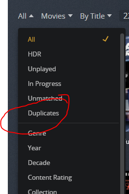

sort by duplicates, they are probably there. Maybe unmatched as well.
I renamed the file to include the date, I checked and corrected all “duplicates and unmatched” and rescanned the movies libraries files multiple times. No joy.
Then I:
removed the file from the server
rescanned
copied the file back to the server
rescanned
What do you know, it was found and matched correctly.
Thanks to all who helped. I’m not sure which part “fixed” it but it is solved and I really appreciate the help.
