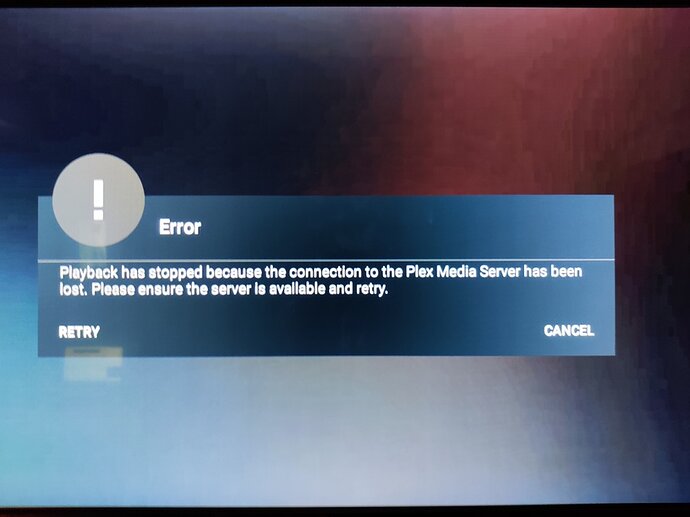

Until recently on my Android TV, I think before the new player was launched, I was able to play videos without any issues but off late I am unable to do so. I can view my library but when I try to pay the videos I get the following error.
I can confirm that there is no VPN issues and Wi-Fi is working perfectly. I can play videos without any issues on my Android phone, though.

After switching the the old player, I am able to play all videos again properly. With the new player enabled, there seems to be some transcoding operation taking place that prevents the videos from playing.

I found what is my problem…
I have the plex server in docker and some weeks ago I changed it to bridge network as described here:
https://github.com/plexinc/pms-docker/blob/master/docker-compose-bridge.yml.template
But only with port 32400 because is the only required:
https://support.plex.tv/articles/201543147-what-network-ports-do-i-need-to-allow-through-my-firewall/
Today I found this:
https://forums.plex.tv/t/bridge-mode-prevents-direct-play-stream/179979
Well, if I change it to host mode all works again, movies and TV Shows, but I don’t have any bandwidth limit as sugested in that thread, so I don’t know what is wrong
I would research a bit more…
Edit to say that Kodi with PlexKodiConnect works perfect in bridge mode, it’s the plex app what doesn’t (mobile and shield tv)
