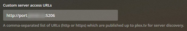

FQDN. It is the “port.provider.com:5206” mentioned earlier. Both http and https links work. If I were to send you a link in a PM right now, you would be able to watch my movie library on your laptop. To be crystal clear, this is how it’s set:
2020-09-30_004715

That means you can look up that IP address, and can enter this in your Custom server access urls...:
https://[ip-ad-dr-es].[yourhash].plex.direct:5206
Look up the IP address for port.provider.com, replace the dots with dashes.
Get the hash by visiting your server’s https://internal.ip.add.ress:32400 and looking at the certificate. (Or by looking at the CertificateUUID in the registry, but that’s harder.)
It should look like this:
https://123-123-123-123.229garbage405a9b.plex.direct:5206
This actually works. My friend has confirmed they can open the Plex app on their Android phone, click the cast icon, launch Plex App on their Android TV, pick a movie and watch it in their desired quality setting. I’m waiting for my other friend to confirm it works on his Apple TV (will confirm).
Thanks for the help! Hopefully this thread will help others in the future.
UPDATE: I can confirm this works for everyone now. We were able to watch 4K documentary remotely on Apple TV, through Apple TV Plex App.
