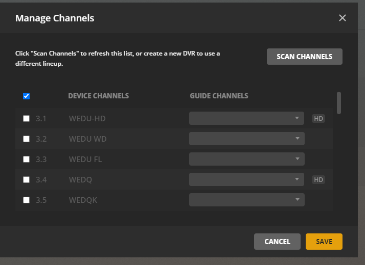

Same issue here. I wanted to make sure it was not my setup so I built a new plex server and I still get the same issue. I am running an HD Homerun Extend. Also, this issue does not happen right away. The tuner scans channels fine, and can tune to them for a few hours before the issue starts up. Also when you go to the tuner channels become de-selected. You can re-select them, but within a few hours the same behavior occurs.
