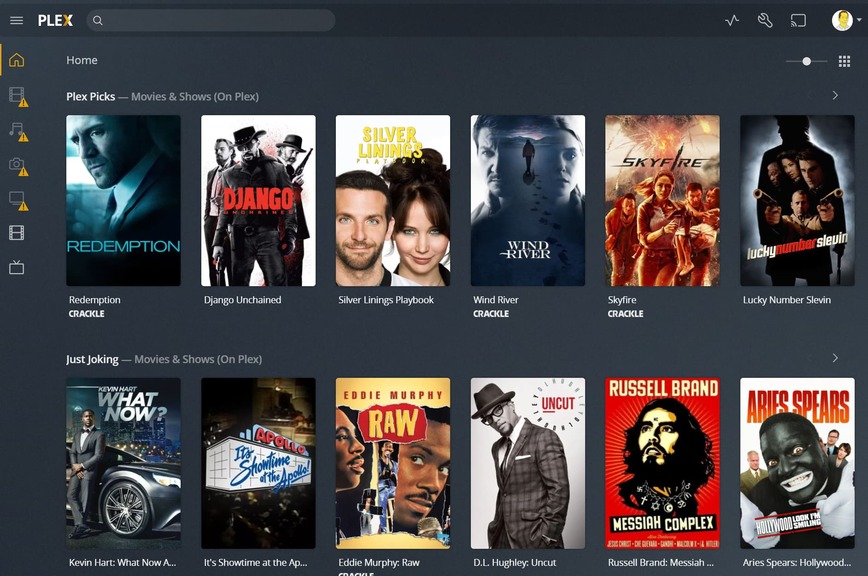

Again today. Restart. Attaching an image of what I see before I have to login to my QNAP and then STOP and START Plex once again.

If this helps, the website says “ERR_CONNECTION_REFUSED” and a client like the TV has no connection to the local Plex server so I don’t see my library.
