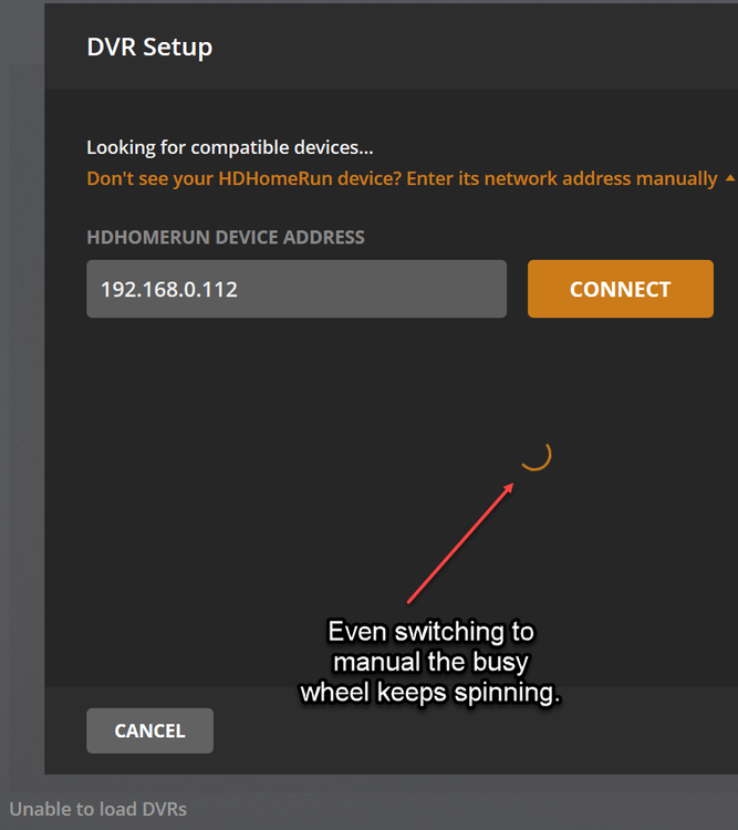

I followed the instructions and the first issue is it takes an age to bring up the wizard. I did notice in the bottom left hand corner the message ‘Unable to load DVR’ which differs from the instruction image.
I clicked ‘Setup Plex DVR’, again this takes so long I decided to enter the IP address manually. At this point the ‘busy wheel’ continues to spin and nothing happens (aka my patience ran out).

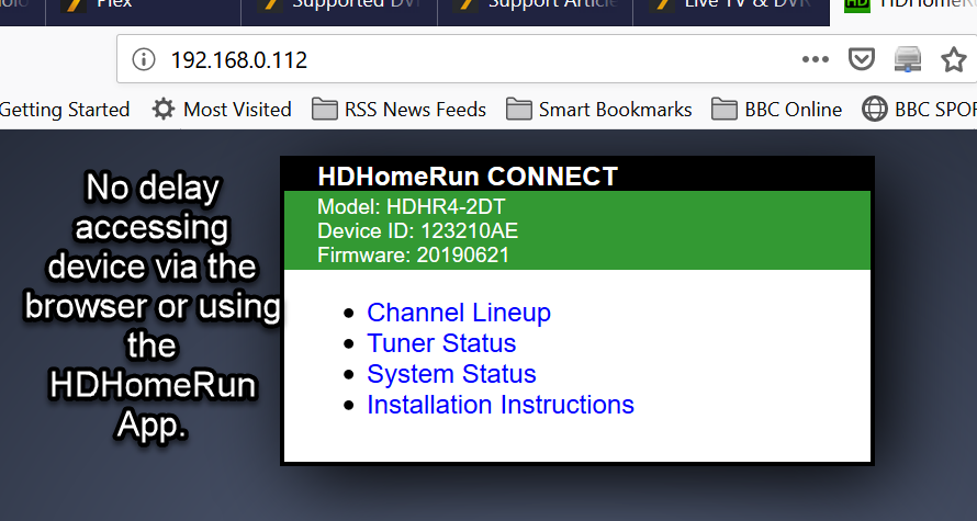

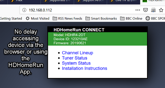

I know the device is connected and working since I am able to use HDHomeRun’s app to view the TV Channels.

I have this exact issue that plex_apc_9254925 describes, except on a Server 2008 R2 Windows server that has been trucking along with Plex and LiveTV/DVR since it was available in BETA. I took one of the 1.16.x upgrades and the DVR was no longer available in the interface and required re-setup… except it never can complete setup.
Downgrading the PMS version sounds like a horrible idea just to get back to where I can delete the DVR to re-add it in current branch. (Though I will resort to it if I must). Any word from Plex Admins on this issue?
For anyone else who has been stumbling through this ridiculous interface issue I was able to piece this helpful information together from other threads (this seems to be an issue for many on this code base and older even). Re-install to an older version will work, but you can also kill/stop the process and restart it. For a short period after restart the “bad” DVR setup will be visible in the interface to delete. You can then safely go about setting it up again. (And waiting hours for guide data to sync down).
