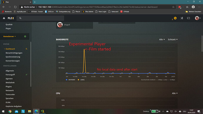

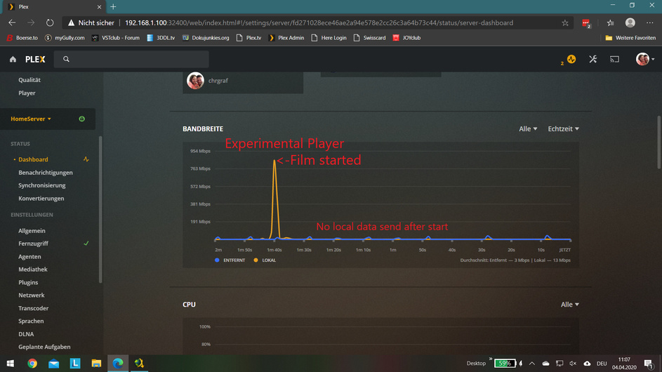

see screenshots with experimental player no data sent after start playback.
Workaround with the old player. Data sent as expected.
