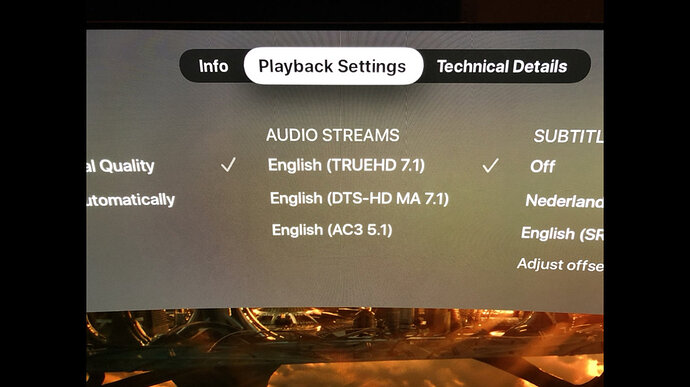

Well that’s the strange part. It does indeed do this for TrueHD, so that’s alright. But for DTS-HD MA 7.1, it says that it is Direct Playing the DTS-HD MA 7.1 stream, but my receiver only receives 5.1 sound from the AppleTV, not 7.1. If it where forced to transcode to FLAC 7.1 as well there would be no problem for me, since that is mostly the same. Big issue for me to mis the two channels from 7.1 to 5.1 though.
Here are two examples:
First one, TrueHD 7.1. Tautulli reports it is transcoding to FLAC 7.1, Receiver sees 7 channels + LFE.
Second one, DTS-HD MA 7.1. Tautulli reports it is Direct Playing DTS 7.1, Receiver sees 5 channels + LFE, so the bottom two speakers on the receiver are ‘missing’.
If this where also transcoded to something like FLAC 7.1. it would be fine.
For MA currently it plays the core track only. Easiest fix is to use Infuse I suppose.
I should probably clarify that it converts the core DTS track to PCM and plays that while Infuse is capable of converting True HD and DTS-MA tracks to PCM, while Plex converts True HD to FLAC on the server for Apple TV.
Plex should probably add the ability to convert DTS-MA to FLAC as well (well at least make it a user selectable option).
