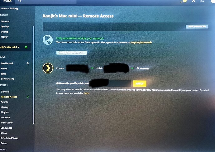

Hi, sorry about the late reply, but I am not sure, my remote access setting looks like the attached picture, nothing about bitrates or anything, will it be on a different menu on the left? Where would I need to go to see the bitrates? (sorry that I’m not much help, this is all over my head…!)

His remote access screen is devoid of the bandwidth settings… That’s kind of strange no?
The features you have in mind require a Plex Pass:
  • Internet upload speed
  • Limit remote video quality
That being said… you don’t need those to get remote access to work
Ahh, that makes sense… I didn’t realize the limiting of stream bitrates and the upload speed specification were Plex Pass only, that seems an odd choice, but it’s cool :slight_smile: The more you know… :smiley:
Edit: Does that mean it’s set to use maximum available bandwidth for upload by default? I sure hope so.
Yep - every control that determines quality/bit rate/resolution are in the player apps at the remote location. <—apart from the Plex ‘sniff test’ on the upload wherein it could just transcode when something won’t fit.
