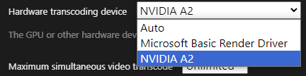

Just finished restarting. Before I test what should I have in the transcoder settings? I still see the same three options.
Logs attached with examples of Microsoft and Auto.

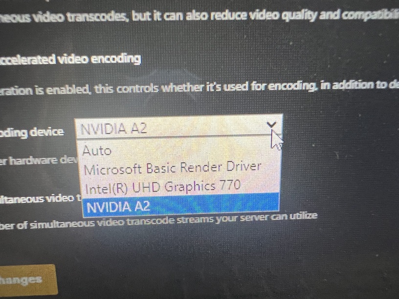

On a side note the Nvidia transcoding is MUCH faster now! Starts in 5 seconds vs almost 30 back in the last build when it worked.

PMS finds my card now:
