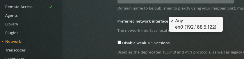

Also on your servers network settings if you have multiple network interfaces. change this Preferrred Nework interface setting to the primary one for its local IP on the network.

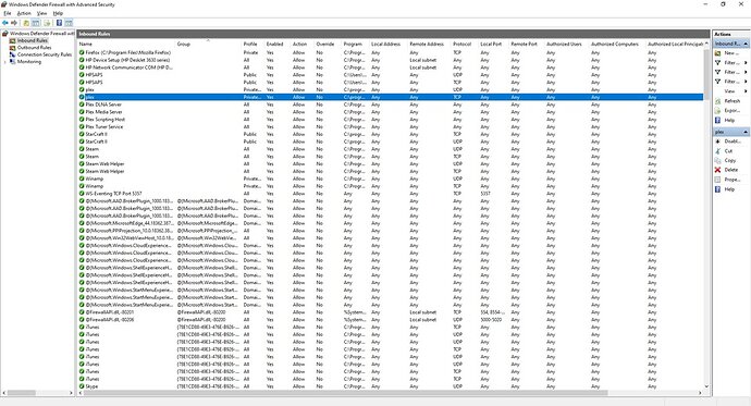

I’m unsure how exactly to check if my PC firewall is blocking 32400. I opened windows firewall and it appears plex is allowed on public and private networks?

My Preferred Network is now set to “ethernet” instead of “nord” where it was previously.

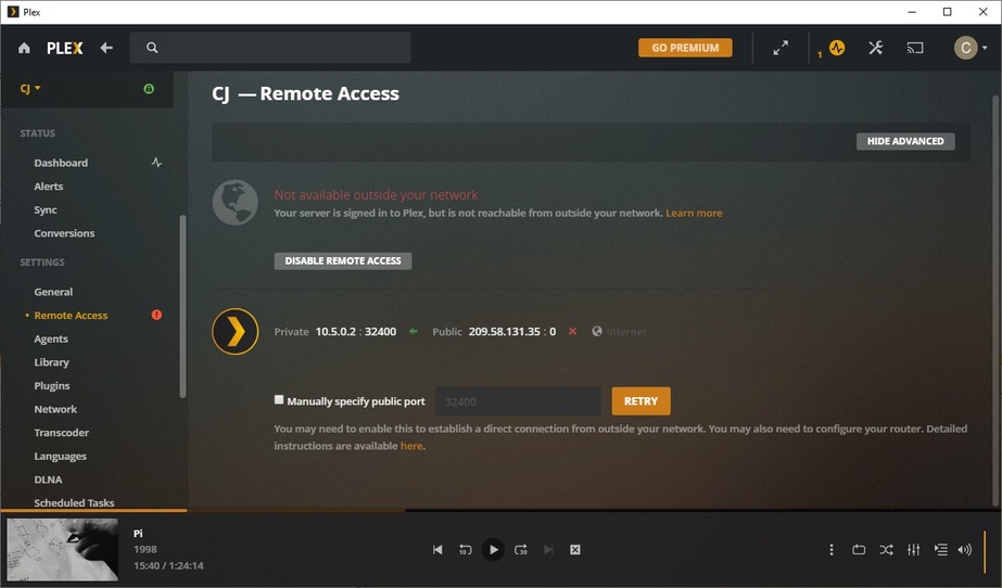

There is also a red exclamantion mark by the “remote access” part.

NordVPN won’t allow you to use remote access if you ever choose to as it does not allow port forwarding in itself. Looking at that remote access page it seems to think that Nord network is your local network. As far as I know 10.5.0.2 is Nord assigned address. your TV likely has an IP that begins with 192 like 192.168.1.5. Which basically means that your server and TV are like they are two different networks
If you did change your servers preferred interface setting to the one that starts with 192 then I think you need to restart the server for it to show up there as the Private/local IP.

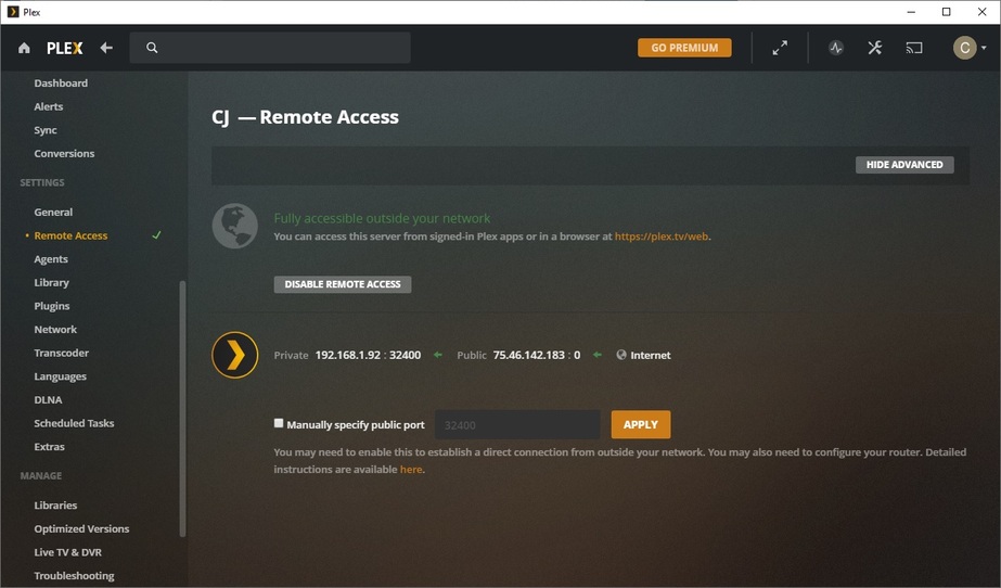

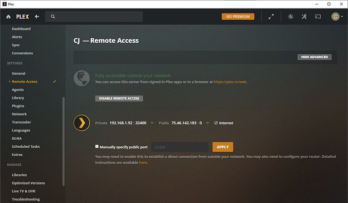

OK, so I disabled Nord and signed out of Plex on both my TV and my PC, and hit exit on both so they were not running. They are the current versions. I signed back in and tried to restart my server, which took a while for some reason, and now it shows a different screen on the “remote access” section. It shows that remote access is “fully accessible outside your network” but shows unknown ip address. TV was still unable to connect to server. After Nord restarted, the server was unable to connect, so I disabled it and restarted it again, and this time it shows the IP addresses like you said it would. Plex on my TV is still totally unable to connect to my server. It did play one video, then when I tried to play other videos they wouldn’t work, then the first video I played also wouldn’t work.
Here are some screenshots:
First time I restarted the server after disconnecting from Nord:
Windows Firewall Settings showing plex is allowed on public and private networks:
Plex Server after second restart with nord disconnected:
Did I read something wrong in my firewall settings?
