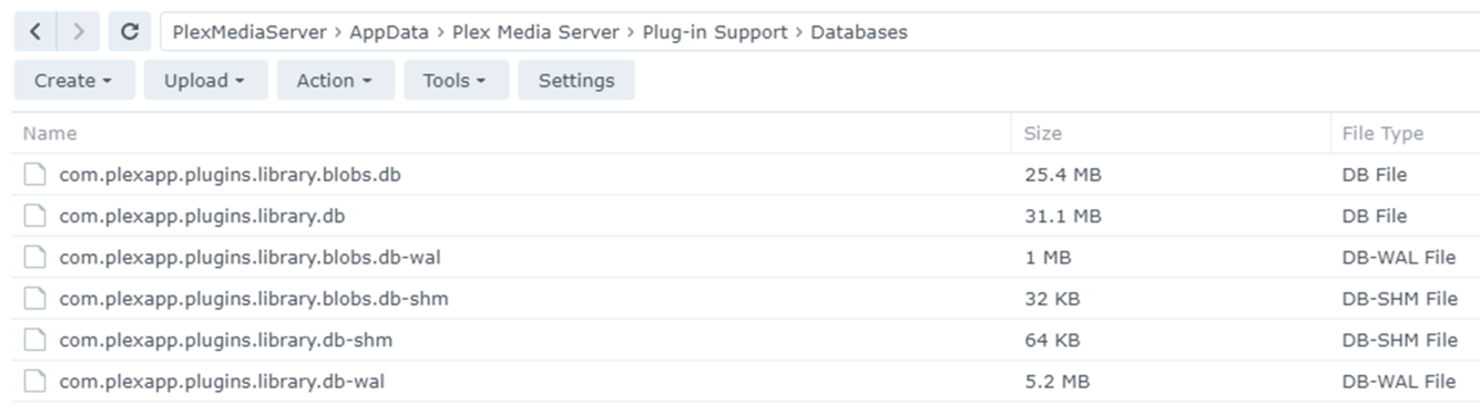

If I go to my NAS, stop the Plex Media Server, then go to this filepath in File Station:
/PlexMediaServer/AppData/Plex Media Server/Plug-in Support/Databases
And copy all 6 files to somewhere else safe
Do the update to the NAS or Plex Media Server, whichever needs updating. Start the server again.
If there’s an issue and I’ve lost all my changes, then stop the server, remove the 6 files and add back in the original two DB files into the Databases folder, and start up the server again.
Is that correct? Is there anything else I need to do?
