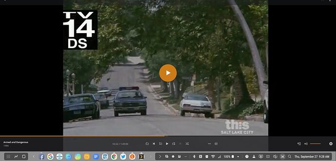

There is another odd thing going on. I set it to record some older movies like “Armed and Dangerous”. When I went in to view them, the movie started playing in the middle of some other movie. If I tracked forward to the hour mark (54 minutes in) in time I found the actual movie I wanted to record. But it was like 53:33 min into it. I paused the moving on this next screen shot to show you exactly where the beginning of the movie is. And, it recorded 1:49 total time. But cut the ending of the movie of!!!
