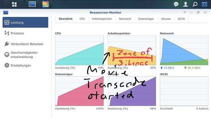

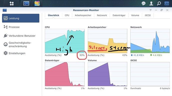

Just stopped SABnzbd and VPN and deinstalled unuseful things. I‘m running PMS again, seeing how it goes. It takes time to crash… I tried to transcode a movie from 1080p to 720p here are the stats:
Seems to be more a CPU-bottleneck than RAM.
You are both CPU spiking and Volume (I/O) maxing.
In this case, since you’re not out of memory, it’s not swapping. This NAS cannot (disk you have in it) isn’t fast enough for the load) and it is the nature of transcoding to spike at startup. The ARMv8 can stream up to 20 Mbps… IF the media is pre-processed correctly. It can’t be given ‘any old stuff’.

Exactly, like the screenshots in my previous posts.
