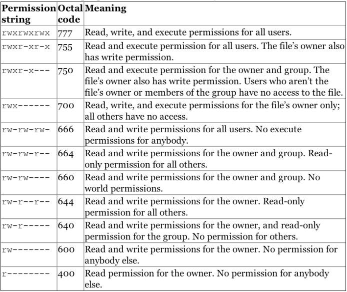

Adding Plex to the superuser group can help in some cases, but each file and directory has separate permissions for the user and group… So if the group privs also aren’t correct, you can still have an access problem.
If you haven’t seen these diagrams yet, they may help.
Permissions issues can be tricky!

I was trying to add some music folders to my larger Music directory, but I got a permission error. Here’s what my entire media directory’s permissions looked like when I entered ‘ls -l’ into the command line:
drwxr-x—+ 3 plex plex 4096 Aug 23 16:34 vrpi
With this set of permissions, I was able to access and play everything in the directory as my pi user (who is in the plex group), but wasn’t able to create or move directories.
If I’m reading the above correctly, that’s because I had ‘rwx’ for my plex user and ‘r-x’ for my plex group, correct?
I wanted to fix this, so I entered ‘sudo chown 770 /Data’. I this gave me the settings I thought I was looking for. ‘rwxrwx—’, which I thought would grant the plex user read, write, and execute, and the plex group (and all its members) read, write, and execute, and then leave all other users unable to do anything.
Instead, I lost all access to all folders. I have since done ‘sudo chown 777’, which makes me nervous, because now all users have all permissions on the drive, right
Why didn’t 770 work?
EDIT: Okay, I changed everything to 775 (rwxrwxr-x) recursively, and I can access and play contents from every folder, but I can’t add/move folders. Plex can access files and play them.
Does this mean that my pi user, who is in the plex group, is considered part of that third “Other” group?
