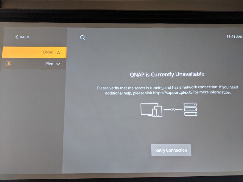

The plex server is hosted on my QNAP NAS. I can play the same media on a desktop with chrome at App.Plex.tv, so it doesn’t appear to be a networking issue.
So far I’m unable to play any media from the Plex server on my Android phone nor on the Playstation 5 Plex app. I tried logging out and back in to the Plex app on the PS5 but that didn’t seem to help.

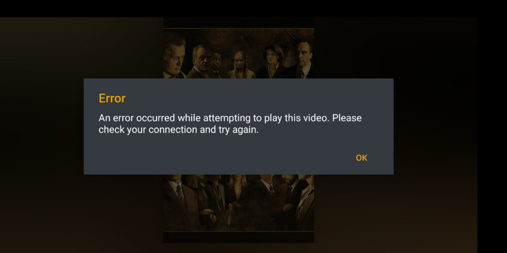

“An error occurred while attempting to play this video. Please check your connection and try again.”

Thanks for the reply. It’s a really frustrating issue and I’m hopeful that a Plex power user will be able to take a look at the logs. I’m attaching some additional images of trying to play media from my Plex server on various devices (all on the network).
