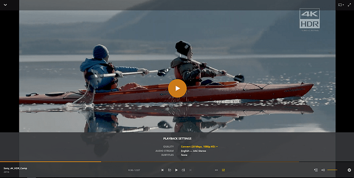

I noticed that the OP’s image of the 918+ transcoding 10bit material doesn’t look washed out like it does when I transcode 10bit material in software on my Mac based Plex Media Server. Is this because of the transcoding in hardware? I’m surprised to see 10bit working since early discussion seemed to suggest that just 8bit worked on these boxes.

Would you mind posting the XML of the video screenshots in your OP ? You have a few curious readers.
I deleted that sample but I will post pictures and xml from other one.
XML:

Thanks for sharing! Do you find that the 10bit material looks normal or is it washed out when it is transcoded? The screenshot looks great, but it’s hard to tell.
