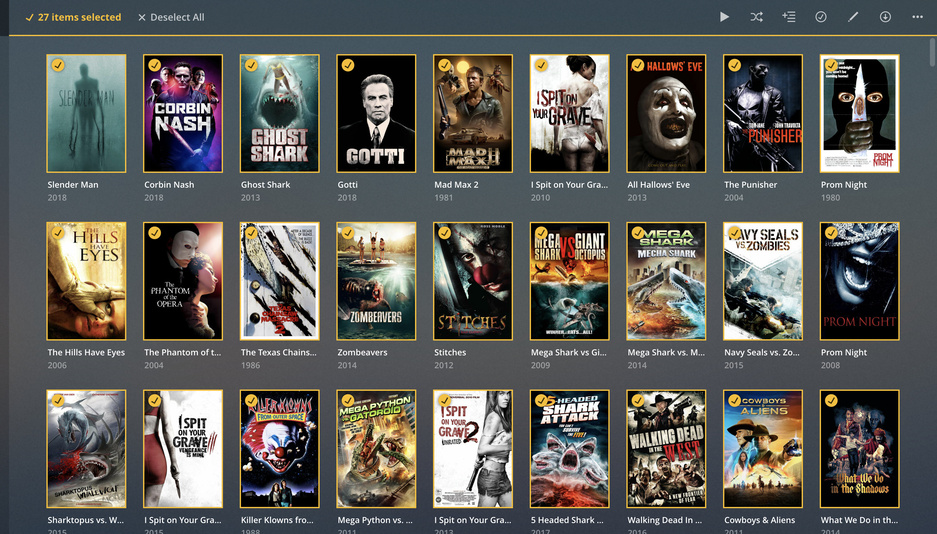

Not sure if you saw the screenshot a few posts back but they show all the files names that are having issues getting Metadata.

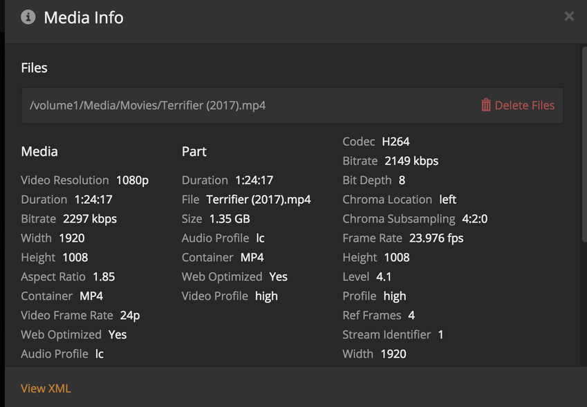

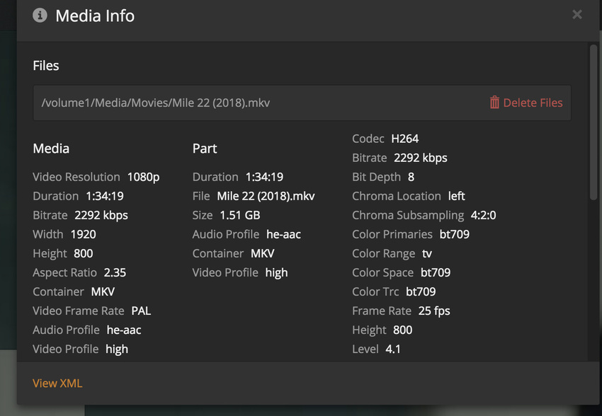

I have attached the XML Files.
Terrifier - XML.pdf.zip (46.7 KB)
Mile 22-XML.pdf.zip (130.5 KB)
Thanks for those.
Names are good. I, personally, erase the Title field so PMS doesn’t even attempt using them.

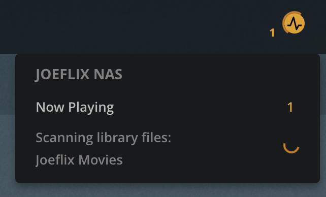

I hope all is well. As you can see I tried virtually everything in the book, there was to try to resolve this metadata issue. After a lot of experimenting, the ONLY thing that seemed to work for me was to believe it or not wait.
There seems to be some “indexing” that needs to get done between Synology and Plex once a new file gets added. I noticed when I added in bulk the time to index took a lot longer than expected, however, I added a few files at a time the duration of this “indexing” was far less. I wish I could pinpoint the solution but it was more a “cocktail” of trial and error until it worked for me.
My typical process involved: Stopping Plex, Clearing out the Plex Cache, Restarting Synology NAS, Running Plex, Ensuring that the files got matched properly with the “IMDB” tag, and lastly running a refresh. When this does not work, I wait several hours and attempt to run a “Refresh Meta Data” again. It works after that.
I cannot explain why, but my best educated guess is that some indexing is required on the NAS-side.
I hope this helps you in your efforts.
