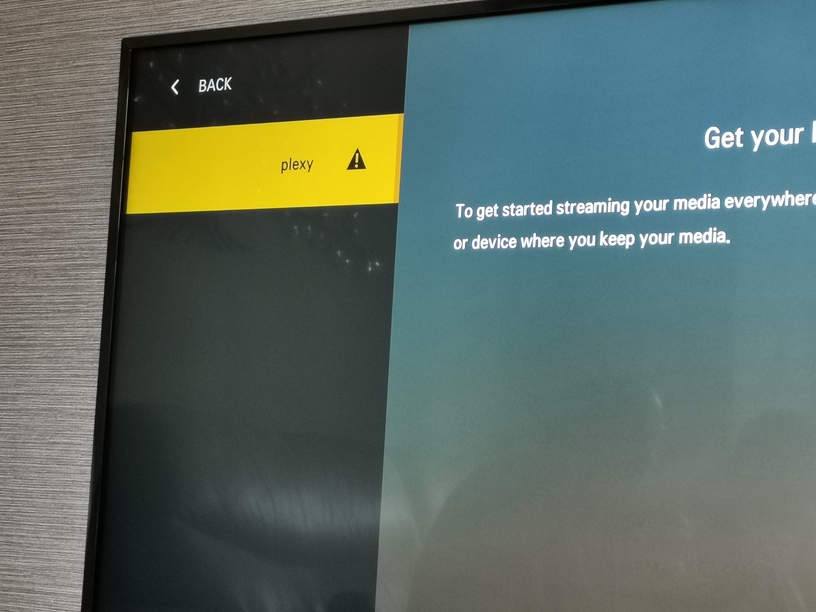

He can use plex, and all thier offerings, bar our server. It comes up unable to connect or the server is offline, when its now and we can use it on our mobile phone when at his house.
I have reconnected the tv to wifi, made sure both tv and app are up to date, changed my settings on the server to see if setting it to allow unsecure connections and still didnt work.

Coolio, ill be back there on saturday so ill take another pop at it as well. Take a pic of the app store on the tv for u

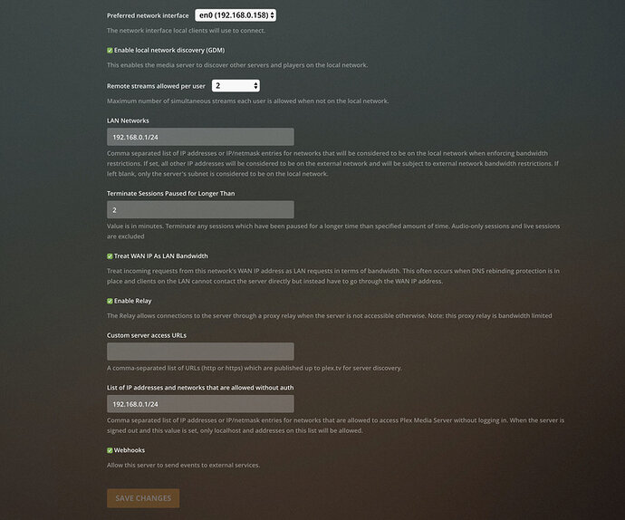

Do you have access to LG Plex app settings?
If so add your Server/Computer LAN IP to Manual Server settings, port should be 32400

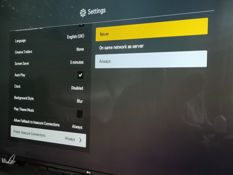

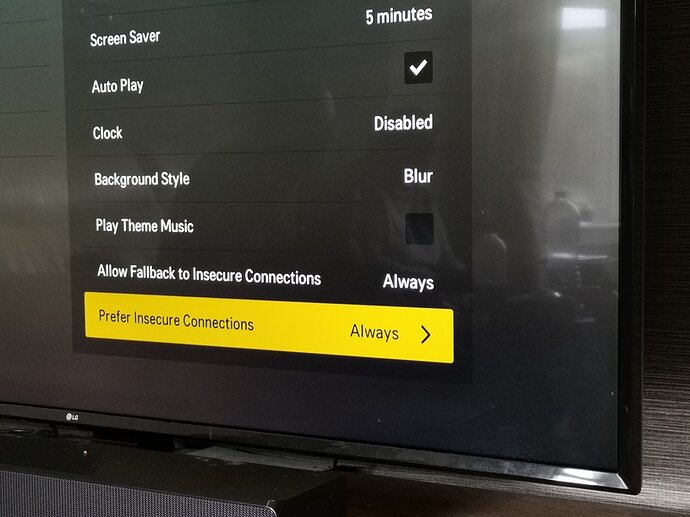

In General settings of the LG app, scroll to the bottom and make sure the settings says “Fall back to insecure connections Always”

So I went in and changed it to work on unsecure connections and set the server to allow it and still nothing, even logged in with my username same issue!
What up address do I use I assume that will constantly change as it’s just my pc at home ?
