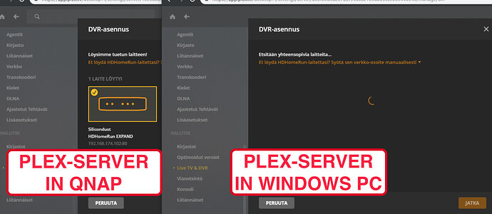

Same problem here, in Finland. Started less than a week ago.
Cannot connect HDHomeRun Expand. Connecting web browser to HDHomerun works OK. Also HDHomerun application (in same computer) connects and LiveTV works OK.
I have two Plex servers and Windows PC -version is running DVDR, and cannot connect to HDHomerun
 any more. Plex server running in QNAP -server does see HDHomerun Expand.
So this issue is only with Plex-server (Pass 1.16.3.1433) installed Windows 10 computer.

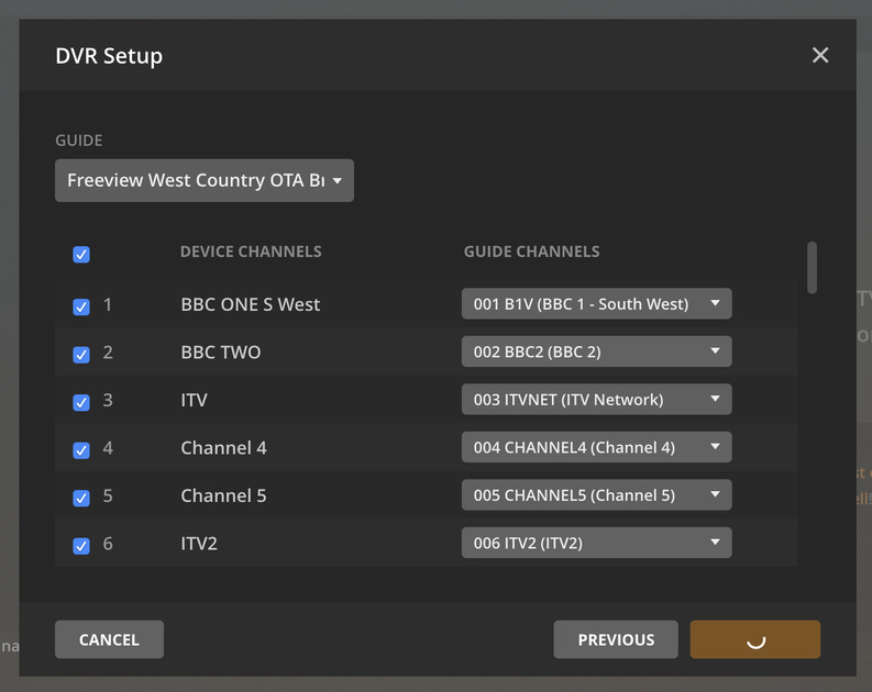

I can’t get past the initial setup.
I get stuck on this screen for the HdHomeRun Duo and with usb tuners.
Restart the server and it appears to have added the tuner.

Thanks for the logs, I can see that Plex Web is getting errors back following an attempt by Plex Media Server to migrate to the new EPG and it failed and it attempted to delete the DVR. This does not appear to have been successful
At what point did you take this screenshot? I have log covering 23:19 to 23:22 - was this screenshot during this period? The screenshot normally follows entry of post code but i cannot see this in the log
To recover the situation we need to delete the DVR, What happens at the moment if you relaunch Plex Media Server and then go to server settings and select settings page for Live TV and DVR? Do you get the option to Delete the DVR?
