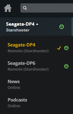

So I ran the PMS and its asked me for my Plex account. I logged in successfully and can see the other PMS servers and libraries I’ve connected to previously (they belong to a friend of mine). What I don’t see is a way to claim or add my QNAP PMS.
Any ideas? Included a screenshot to help illustrate my dilemma at this point. As always any help greatly appreciated.

Went through these steps and no joy, same issue. I have a related question. Does it matter that I started my account in order to view my friend’s PMS and now want to add my own PMS? Is it “confusing” the software? I ask as I see no way at this point to add my PMS to my account. All of the guides, manuals, etc that I’ve seen show a plus icon or similar methods by which a PMS and libraries can be added. I see no such icon on my account.

Thanks @dane22. I’m not a member of his Home, at least I dont think he added me that way. I’ll have to check. But in reading the supporting article you included it stated that I can switch PMS and libraries amongst the users. The problem for me in this context is i dont see a way via the UI to add my PMS to my account. how do we fix that?
