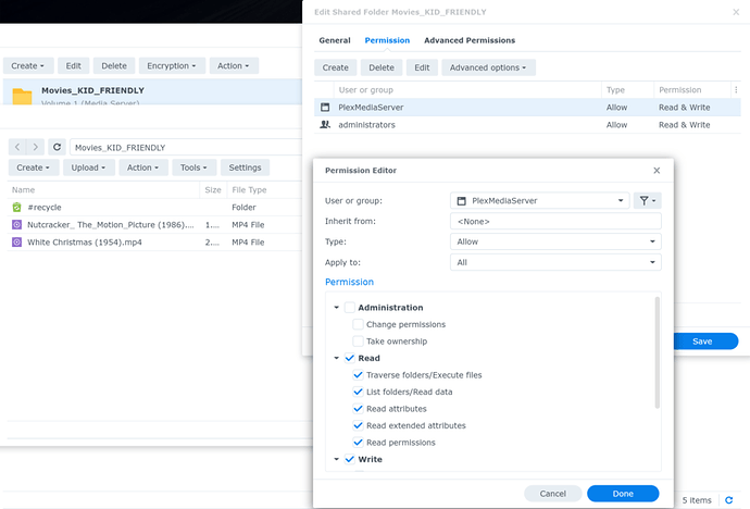

For this second try, I installed the Plex Beta through my Synology DS920+ Package Center, then Manually installed the current update as required in the instructions. Adding the correct permissions for ‘PlexMediaServer’ under System Internal Users, as screenshotted, and proceeded.
I also went back into the File Station, and ensured the ‘Apply to this folder, sub-folders, and files’ was checked after I verified the permissions were present.

Did you make certain the permisions were applied to this folder, sub-folders, and files?
Hello,
Yes, verified that Read/Write permissions were applied to all subordinate files/folders as seen in screenshot:
No change in the Library.

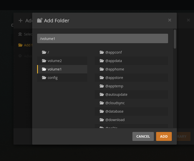

May I ask what \\Media\Movies_KID_FRIENDLY is?
I think you’re trying to type in the path name instead of clicking to it ??

You’re typing windows pathnames. They don’t work with Linux.
Why not click on them?
Like this? ( I will add my “Movies” shared folder which is on Volume 1 )
Start at the top, scroll down and click 'volume1
Notice is has /volume1 at the top. Now scroll down and find movies
Now you see /volume1/Movies on the top bar. In the right pane are all the movies in that shared folder.
For you ,.
/volume1/Media/Movies_KID_FRIENDLY
is how it should look
Now you click ADD
Success! I knew I had missed something easy. I had copied/pasted for the Folder name before, I think I accidentally did the same for the path instead of selecting from the file structure.
Thank you again for your time and patience, ChuckPa.
