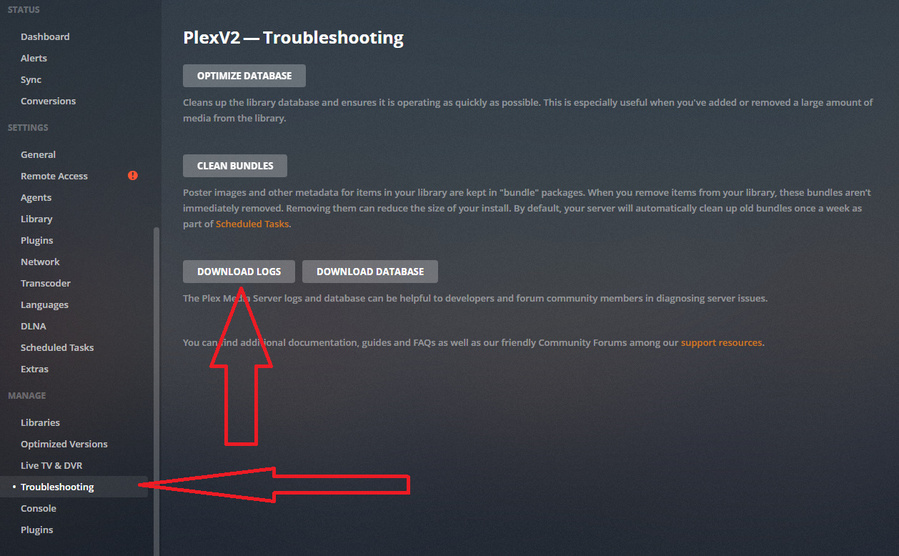

PMS is Plex Media Server, sorry. From the Plex app in Chrome go to your settings, then click on troubleshooting at the very bottom left, then download logs.
