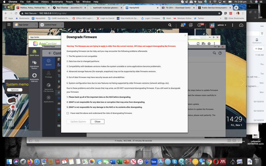

Ok. I get the following warning msg. hence my confusion with your message.
This is correct.
Depending on what apps you have installed, you will need to uninstall the QTS 4.4.1 versions and re-download the QTS 4.3.6 versions.
This is normal. Do not be alarmed.
