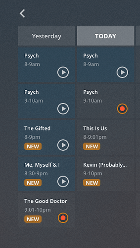

Recording showing in progress and 100% complete.

I’m on Version 1.9.6.4337 and I am seeing an issue with 1 show consistently getting hung at 100%. It is the Today Show. It has done it each of the last couple of days.
I don’t have debugging turned on in the logging (Did a rebuild and clean install and didn’t turn it back on)
One thing I did just notice is that there are 3 recordings going on but only 2 tuners.
I switched back to 1.9.4 and everything seems to be working well. Going to stay here for a while.
I’m now see this problem too. When I looked at Plex this morning I see 7 recordings that are stuck at 100% from last night.
Running Plex 1.9.5.4339 on Windows 7 and using a HDHomeRun Connect
After I restarted Plex some of the recordings show up as complete. But they are all 3 seconds long and all have recorded from the wrong channel. 3 of recordings have the same 3 seconds (recorded 3 seconds from the same channel).
