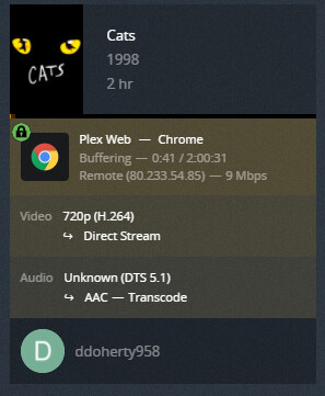

My dashboard says remote:
It seems to be connecting fine, but the buffering is still an issue. 2Mbps is still the highest I can manage.
