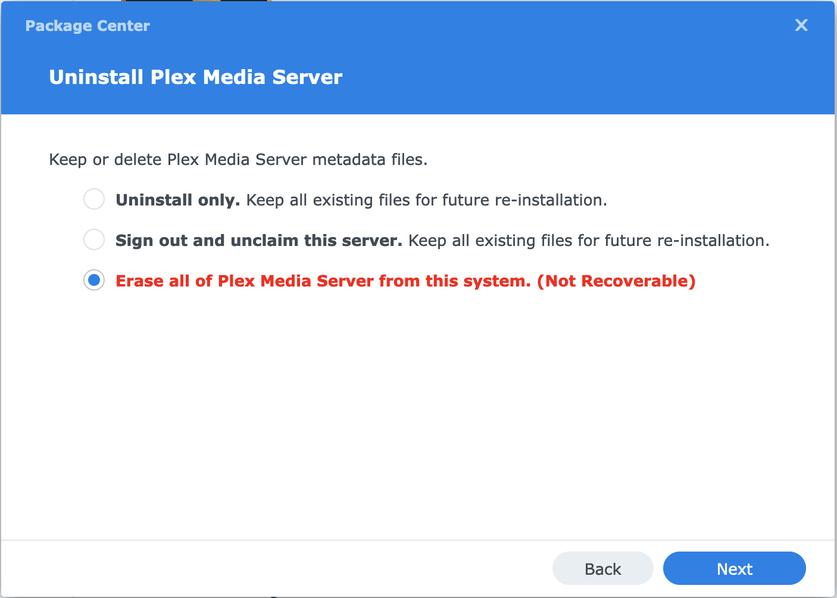

  1. Package Center → Plex (1.21.0.3744 – which is the no-longer-working-beta)
    – Uninstall it with the ERASE option (from the menu it gives you).

Yes. Correct. Uninstall 1.21.0.3744 and the empty server instance it created.
We don’t want it to interfere with moving all your DSM 6 server data to DSM 7

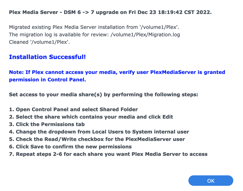

Open a new browser tab to the Syno and look in the “Plex” shared folder.
You’ll see a “Migration.log” file.
This file keeps track of the progress as the installer does everything it needs to move your server from DSM 6 → DSM 7.
Yes, Manual Install.
When it’s done,
  1. There will be no “Library” directory in the “Plex” share. You can use or delete as you deem appropriate
  2. User “Plex” won’t be needed
  3. You’ll have a new “PlexMediaServer” shared folder.
    NO MEDIA IN THERE PLEASE.. It’s fragile
  4. You’ll need to change permissions on your shared folders to access the media.
    I’ll post that link next.

To set your media shared folders for PlexMediaServer (the new package name and user name)

The steps are:
  1. Set the permissions in the “Plex” shared folder so the PMS application and its metadata get migrated to the new structures for DSM 7
    – (this is the pain. They made us change the shared folder and username – AND – took away all the privileges I used to have in DSM 6. Had this been DSM 6, I’d do everything for you automatically)
  2. After all the permissions are set, Now “Manual Install” the 1.29.2 SPK file I gave you.
    – This is where you can expect it to sit at “Installing” while it takes everything from the “Plex” shared folder and moves it to its new home in “PlexMediaServer” shared folder.
  3. Now go to each of your media shared folders and change “Plex” → “PlexMediaServer”
