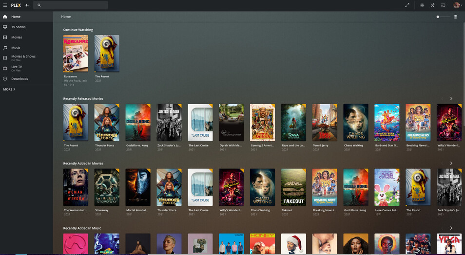

I have TV Shows set to show on my HOME. And they always have shown up. But all of a sudden the Recently Added tv line isn’t showing up anymore. And if I go to the TV section:

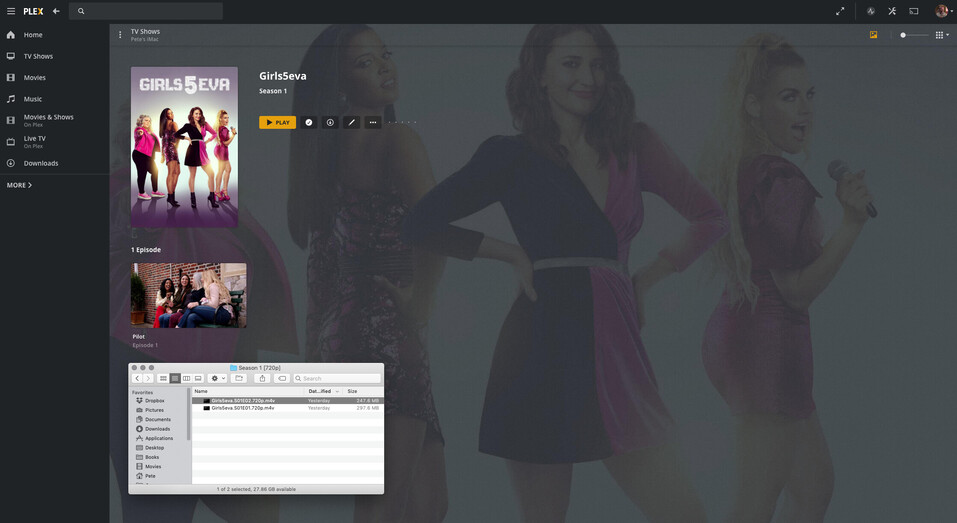

And not sure if its related, but some tv shows arent showing up, no matter how many times i scan or redo it. And the files are exactly the same.
