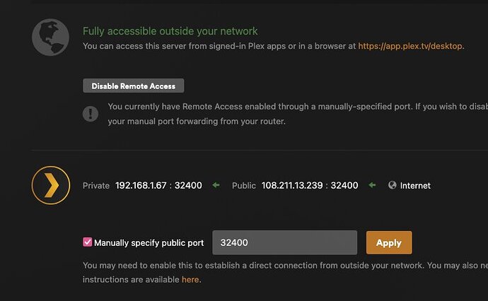

I am only able to download content to Plex Player (18.5) on my iPad when connected to my local network. I cannot download content remotely. Even though Settings>Remote Access shows “Fully accessible outside your Network”. I have an AT&T Humax BGW320-500 router. I went under Firewall>NATGaming and setup the Manually specified port. That is what made the “Fully accessible outside your Network” status turn on. But I still can’t access it outside my network.
I have two instances of Plex Media Server, one PMS running on my Synology DS1821+ and another running on a PC. Both Servers show “Fully accessible outside your network”. But I cannot download to my iPad from either server outside my local network.
