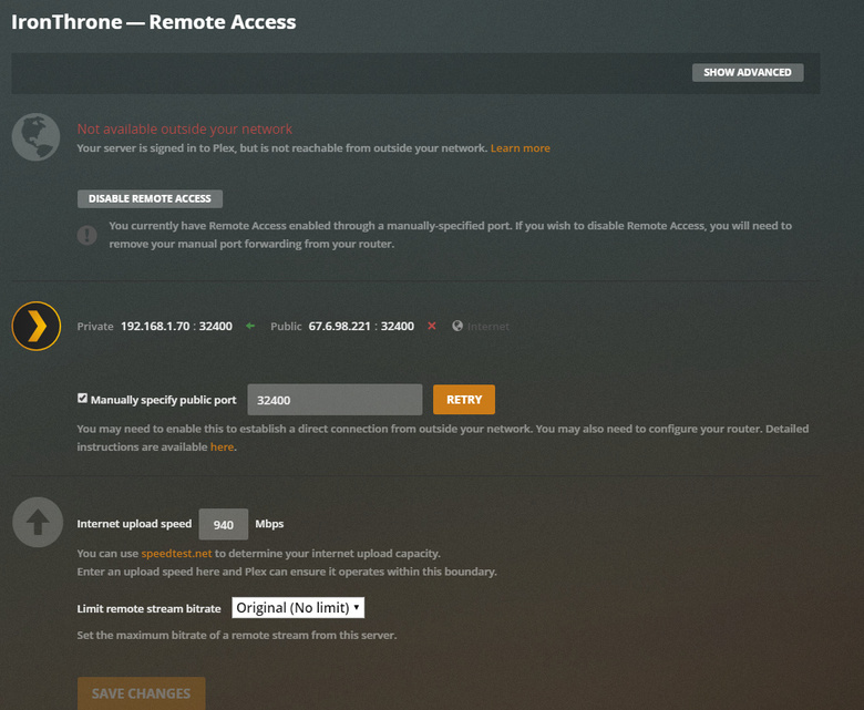

So I have checked that, and through yougetsignal.com I have checked the port 32400 is open as well. Here’s my remote access page. For some reason, it’ll say “not available” but if you hit retry it’ll clear up. And if I go to another screen, then go back in it’ll throw that same “not available” message again. I tried it myself this time with just some music. Also I have a new log file for you, as I just tried again couple hours ago, this time look around the 16:15 time. This time it was my phone with music.

According to your logs, the client is losing its connection w/ Plex guessing the connection might have been disconnected. However I’m not sure this is actually your remote stream.
