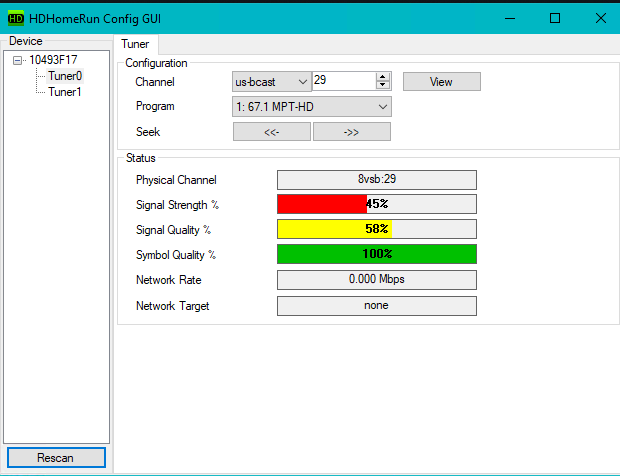

Anyone else having a similar issue? All my shows all day have this problem…They start fine and look good…you go halfway through the mpeg 2 recorded show and its all garbage. Its not a signal issue…opening HDHOMERUN Config GUI I can see that the network rate has dropped to nearly nothing…it will sometimes spike to 3 mbps for a second but then back to 0…hd is 7 mbps or there abouts continuously. If i break the recording and stream directly to vlc on the same computer as my plex server i have no issues 7 mbps across the board…anyone have any ideas?
Deleted and readded the tuner…still have the same issue…records for about 1-2 minutes fine…then dies
So even my perfect channel has this issue…98 % signal quality and still dropping after a few minutes

EDIT: Went through a few more troubleshooting steps…reinstalled plex server, tested recording directly to main ssd …always 30 seconds to a minute and it stops the correct data rate like the plex server gives up on it
Also transcoding has no effect… Will still break 1-2 minutes in
