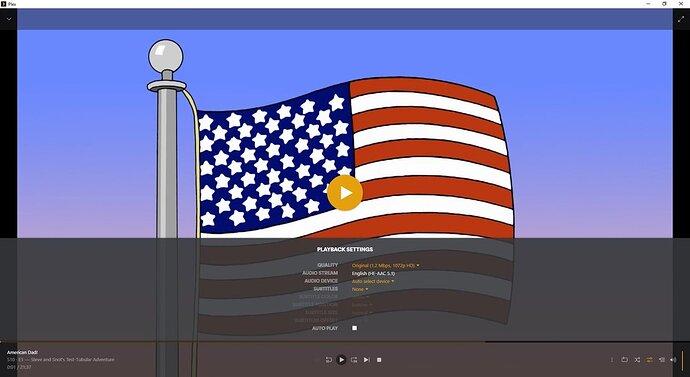

Here I have a HEVC 1080p 1.2 Mbps video.
I set it to play at “Original Quality” and it is direct playing as expected.
I change the quality all the way down to “480p 1.5 Mbps” and it still direct plays because 1.2 Mbps < 1.5 Mbps.
According to you that would transcode because 480p < 1080p.
What are we doing differently to see different results?
I tested using Plex for Windows Version 1.76.2.3951-15712eae. I also tried Plex Web Version 4.116.1 in Chrome and got similar results except it direct streamed instead of direct played, but still didn’t transcode.
Edit: Plex Media Server Version 1.32.7.7571

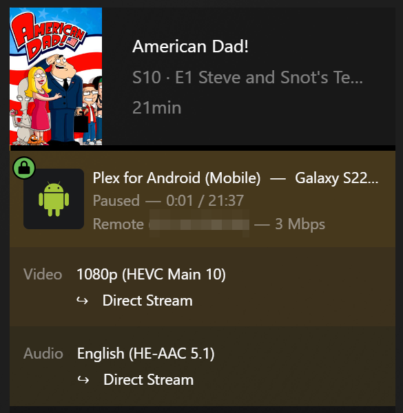

However, I also tested it on Android (Plex for Android 10.2.0.4374) and it still direct plays with a lower quality selected.
At this point Plex is behaving as I expect (direct playing) on more platforms than not. So I am leaning towards a bug or limitation specifically with iOS rather than a general issue.
I just checked on Android (exactly same version as you) and it transcodes as well.

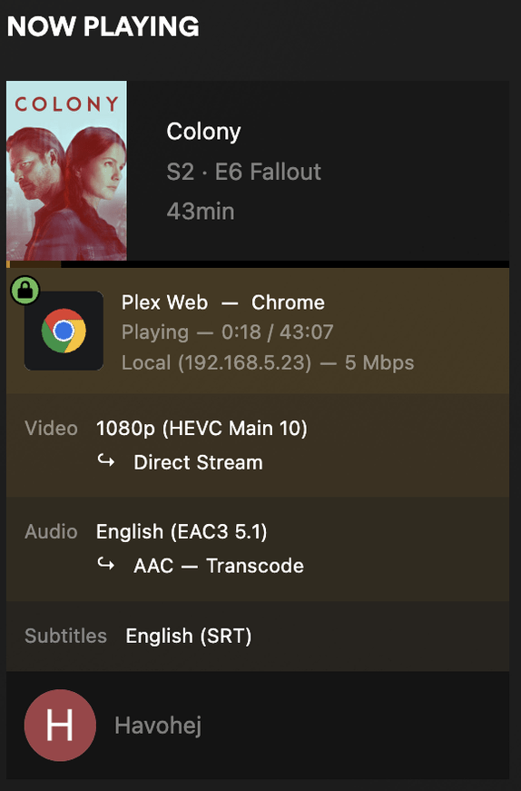

Could you show a screenshot of direct play at original quality and transcode at a lower quality on Android.
Mine changes to direct stream, not transcode.
