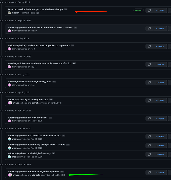

This isn’t what I mean. You essentially did the same thing in Github.
Maybe this is clearer:
The file libavformat/spdifenc.c is identical at both of the commits identified by the red and green arrows. You effectively reverted 9 commits. Is it necessary to revert all 9 of those commits?
What I (and any other dev) is asking for is to start with the most recent version of the file and make the minimal changes necessary to that version to accomplish what you need. If I were to guess you intend to revert the commits on Feb 20, 2020 but that isn’t clear from the information you’ve provided thus far. If that is really the case, then you should use git revert on each of those commits (in reverse order) and push that to a branch.
