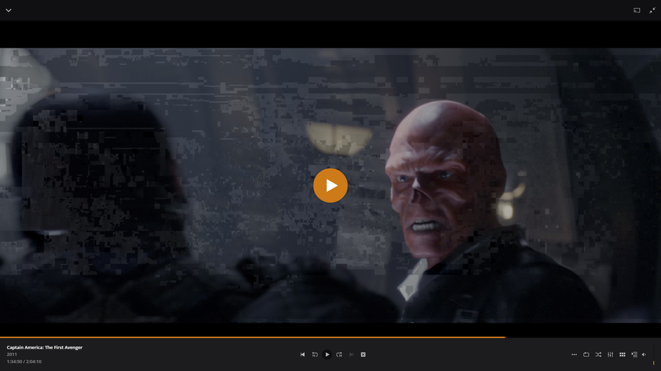

Here’s the blockiness I was talking about:
What’s the the source file? 4K? HEVC? 10-bit/HDR?
4K HEVC Main 10 HDR

rafisher79, I’m suspicious the blocks you are seeing are colors that are getting cut by the conversion of HDR -> SDR. Plex isn’t doing any conversion here, so Plex is simply telling FFMPEG to process as 8-bit even though the source is 10-bit. This causes a hard cut of the colors outside the 8-bit space which I have seen result in washed out colors. I will run through some tests on some 4K HDR media I have here and see if I can recreate the blocky result.
The color issue can be fixed with a tonemap function within FFMPEG, but it also requires some libraries that are not built into the Plex build of FFMPEG. On top of that, the tonemap function currently is software only and limited to a single CPU thread. This means that right now, tonemapping isn’t possible with Plex and if it were it wouldn’t be fast enough to support a live transcode. In order to prevent the color issue, the 4K media needs to have a second “Plex Optimized” copy that has converted the coloring to 8-bit NV12 pixel format.
https://stevens.li/guides/video/converting-hdr-to-sdr-with-ffmpeg/
This is a really good blog post that goes into the what, why, and how to handle this with FFMPEG. I have already tried to do this conversion with Plex, but Plex does not have the zscale filter compiled in currently.
So sadly, for the time being, HDR content (4K and otherwise) on Plex should still remain as direct stream only.
Yeah, I was thinking it could be that, but its weird though - since when I use the CPU decode, it doesn’t have the blocks at all on the very same file.
OK, its definitely a plex issue. I forgot I have emby on that server as well and its not getting the blocks and still using the GPU. Oh well, I guess I’ll just be patient :slight_smile:

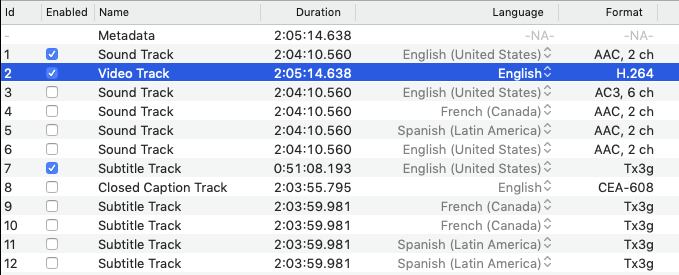

Here is a screenshot from one of the MP4 files in subler:
CA
I suppose that the MP4 container can have quite a few streams. And this notation is how plex passes the stream to the transcoder.
In the example above, #0x02 is the video track. The 6 channel audio track is #0x03
/usr/lib/plexmediaserver/Plex Transcoder2 -codec:#0x02 h264 -codec:#0x03 ac3 ...
When I change the player to a different audio track, like stereo, it also changes the parameter sent to the transcoder to #0x01:
/usr/lib/plexmediaserver/Plex Transcoder2 -codec:#0x02 h264 -codec:#0x01 aac ...
