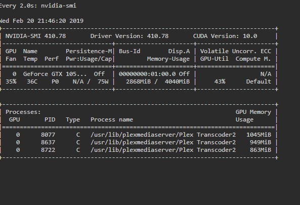

FWIW, I’m able to get, I’m able to get 4 - 4k ~50mb transcodes --> 1080p 20mb with a 1050ti before running out of vram for a 5th. 1050 ti 4gb
@depreciated is that on windows, or linux via the current nvdec hack ?
linux with the hack and with the process issue I am having

I unlock the 1050ti, run the nvdec script and I’m back with high unusually high vram usage again. What I just now realized was that I wasn’t actually transcoding 4 streams with the 1050ti last night. I was using the 4770’s igpu. If you check my first post, you’ll see a few procs with 45MiB.
That was just encoding and not decoding. Here’s how I can tell.
I queue up a video on an iPad and hit start. nvidia-smi shows 1 process running. I then convert to a 20mpbs 1080p and it starts a second process but the first one doesn’t get killed. That’s the problem I mentioned earlier. I kicked off 2 more streams (different files but all within the same 50-60 mpbs mark) and then restart the docker. All three devices pause for a second but then I’m back to only three full hardware encode/decode processes. I can verify this using the nvidia-smi dmon -s u command and i’m sitting around 60% decode. Awesome sauce but I have a big, blocky problem.

Change the script to use exec and the processes will behave as they should
#!/bin/sh
exec /usr/lib/plexmediaserver/Plex\ Transcoder2 -hwaccel nvdec "$@"

Every process on Linux has a parent, up to init (PID 1). If you run a script/program from within a Bash script, that process becomes a child of Bash (via fork). This means the process topology looks like:
Plex → Bash Script Hack → Plex Transcoder
Plex is unaware of the third process, it believes Bash is the transcoder. If it kills the process, it’ll think it killed the transcoder – when in reality it’s still running.
With exec, the transcoder replaces the Bash process, so topology is:
Plex → Plex Transcoder
Which is what Plex is expecting.
Well today I learned something new! I always thought a child process dies when the parent does, but apparently not. That explains the behavior some of us have experienced.
Edit: Updated the docker image adnanklink/plex-norelay-hwdecoding and so far so good but Ill report back if I see anymore hanging processes.
