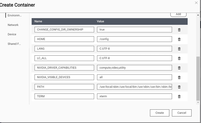

I downloaded it and got inside via port 32773, but It cannot find my local server (Actually it finds my remote server…). How Do I configure it to find my files on NAS and old metadata?
Also I noticed on setting there is amd64 in use? I have i58400T + 1050 on NAS
BTW. Should I run some other Docker on side, because I only run this.
Now I found my server… But I cannot get GPU to work with my NAS.
In cointainer I have selected from dropdown menu my Nvidia card.
But When I run 4K video i get 50% processor, but GPU load 0%
