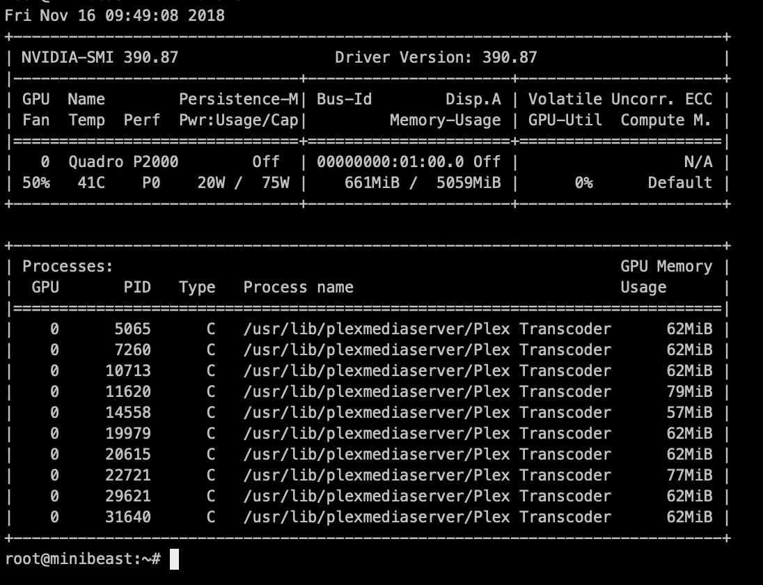

this is useful to see how much GPU is being consumed.
watch -n 0.5 nvidia-smi pmon -c 1

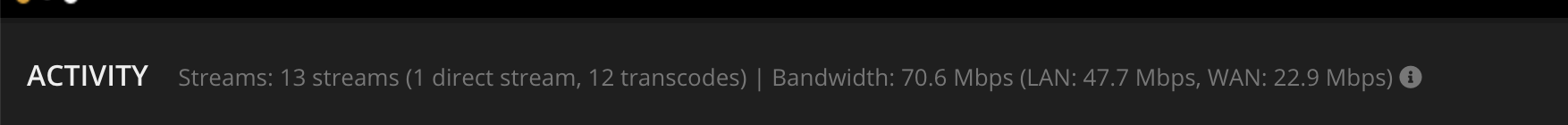

mostly 1080p x264 DTS transcoding down to 720p AAC 5.1/stereo
P2000 and i7 8700
nvtop is useful as well if you haven’t already played with that.
Someone wrote a netdata plugin to graph GPU usage as well. For anyone interested.
