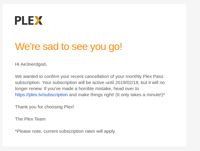

Emby 4.0 looks very shiny right now …
can confirm emby’s shininess
:star_struck::star_struck::heart_eyes::heart_eyes::eggplant::sweat_drops:
I LOVE HOW IT SHOWS ME MY OPTIONS BEFORE I EVEN SUBSCRIBE COUGH WINK HINT ETC
goodbye mustard yellow tyranny!!
PS im realizing some of you picked the “lifetime” subscription. good luck plexers!
I’m about to do the same, I already bought Emby and man is awesome! Plex needs to get there sh#* together!!
