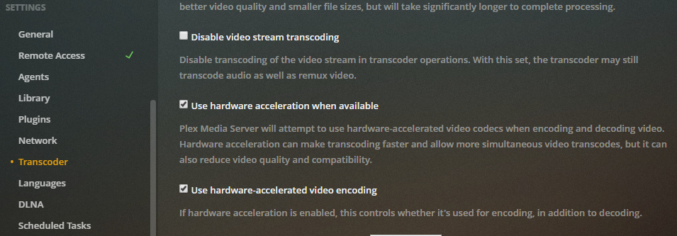

alternatively, the 1080 should be able to transcode a few as well, irrespective of the cpu.
you have plex pass already, go into your server settings and ensure that hardware transcoding is enabled.
if you have an old version of PMS (you did not specify), you may want to update.
