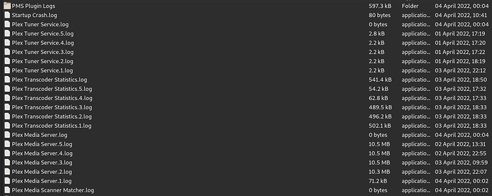

@ChuckPa Please see dropbox link Dropbox - Logs.tar.xz - Simplify your life
My computer crashed and I had to reboot and the same thing happened again.
Whatever you have going on is not good.
If you look at the logs you sent me, several of the files are 0 bytes length.
Rocky Linux is not officially supported. Until you just mentioned it, I was completely unaware of the distro.
I recommend checking the ownership of all the files in /var/lib/plexmediaserver/Library/Application Support/Plex Media Server.
It looks like something is playing in there when it shouldn’t.
