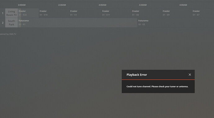

Can anyone help me with a problem? I’ve set everything up. The guide works great, I added my logos, Plex pulls the guide fine. I tested on 4 different clients (web/iPhone/Shield/Roku). Everything works fine EXCEPT on the Shield. The app on the Shield says the tuner is offline. However, none of the other clients are showing this let alone it not working. Can’t figure this one out.

Yes all are on the same network.
Edit: Just checked and it works fine on the AppleTV as well.

Ok so… I feel like an idiot. Apparently the Shield had an older “setup” pinned. I found the proper DVR in More. It’s working but still freezing but I see others are having similar issues.

I think I set this up all correctly but I cannot actually play anything back.
Any ideas?
Edit: lol, nevermind I forgot to install ffmpeg. It’s working now and I’ll report back on how it runs

Same exact thing happened to me. I found that I had 3 Live TV & DVR, but only 1 worked.
