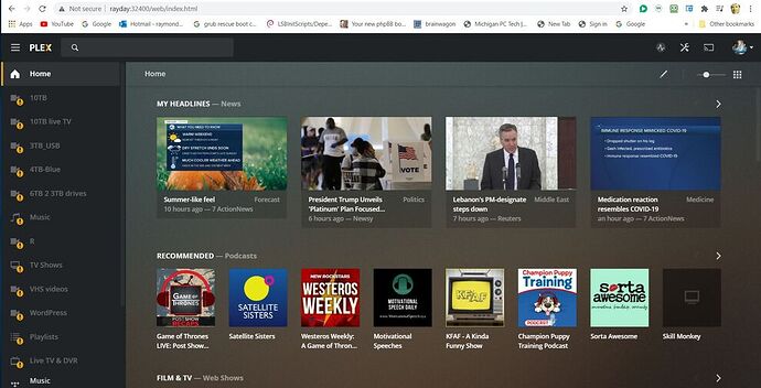

This is how it looks. Error were my videos is now.
It save the Libraries names. But looks like it don’t know any more then that.

OK I got the /var/lib/plexmediaserver folder copied from my backup.
But before that it was still scanning my 10TB drive when I got up this morning.
I renamed the /var/lib/plexmediaserver and refreshed the webpage and it was still working so don’t know where it was getting it from.
That’s what the /var/lib folder looks like now. See got 3 plexmediaserver folders eached name with ~ at the end of them did not went to delete them till got it working good. The one with just one ~ is what the .deb package installed. The one with ~~ is what I copied from the backup and the one with out is the new one I copied from the backup I just made again. But see its Owner is “squeezeboxserver” I do have that working and restored it good. So it was like that on my old OS and worked.
