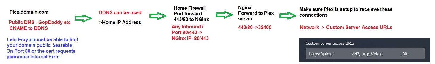

Hope this helps @Plexihexi1231,
I don’t suggest publishing your DDNS on forums (security issue as it’s easy to find your IP from there), the URL times out, so it could be your firewall not forwarding to your NPM. Normally if you get the forwarding working the NPM will have a default splash page that you will hit, then you can setup the forwarding host.

That looks like the default page you hit if you have not setup a Proxy Host on your NPM or using the wrong port.
See @RichardU comment here, Remote access solved with NGINX Proxy Manager - #11 by RichardU
Check my image again and make you carefully read each URL and port requirement.
A final thought, make sure you specify the domain you’re using in your local DNS or if you don’t have use the host file in windows to point the domain to your NPM. This will allow you to test internal the traffic and connections work before making available externally.

Normally this happens when port 80 is not open to NPM, as inbound through the firewall. Port 80 is needed for Let’s Encrypt to request and renew certs. LE also must be able to resolve you domain name on port 80 for the cert to successfully be requested.
This may have been unclear (Edited) the image; you should have a domain name point to your DDNS name using a CNAME. LE needs to be able to find a publicly searchable Domain name to do a lookup on and DDNS point back to your home IP. Remember your DDNS name is only known to you and LE won’t be able to do a lookup on it.
I suggest looking at my image again,
I think “domain name point to your DDNS name using a CNAME” is the culprit. I have a DDNS (duckDNS or Dynu) pointing to my IP. but what exactly is CNAME?
