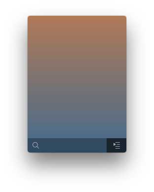

The behavior I’m seeing is when changing to the pipe output, restarting plexamp via ‘systemctl restart plexamp’, and setting the player to “PlexPiAmp” (my pi), the plexamp screen on my mac just stays blank.
Here are the contents of the tmp/mpd.log file. I don’t think it’s even attempting to play audio.
