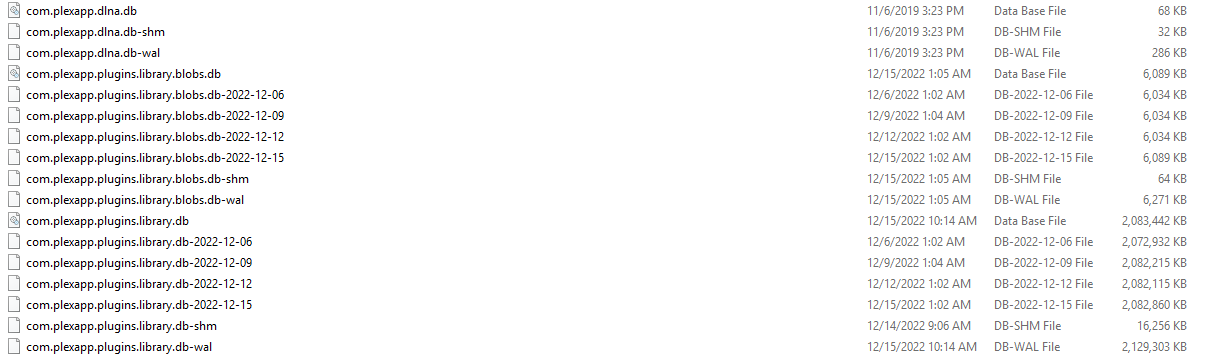

Not sure if this has anything to do with what’s being discussed here, but I checked on the size of my databases yesterday and noticed that I now have a com.plexapp.plugins.library.db-wal file that’s larger than my current database. It was tiny just a few days ago.
This is the same thing that happened to @jaquestati in this thread Library database doubled have db-wal database of almost the same size as the regular old .db file, but for some reason I am unable to reply there.
I’ve never had a corrupt database or any issues related to database performance. What could have caused this?
WAL is the SQLite write-ahead log. In-flight transactions are written to the WAL first.
WAL files can grow for a number of reasons, and a large WAL file isn’t necessarily a sign of anything wrong. It can be but it’s not an immediate red flag.
WAL files should be removed when a database file is closed cleanly.
If you shut down Plex, are the WAL files removed?
If not, after stopping Plex, does running Plex\ SQLite com.plexapp.plugins.library.db "select count(1) from accounts" remove the WAL file?

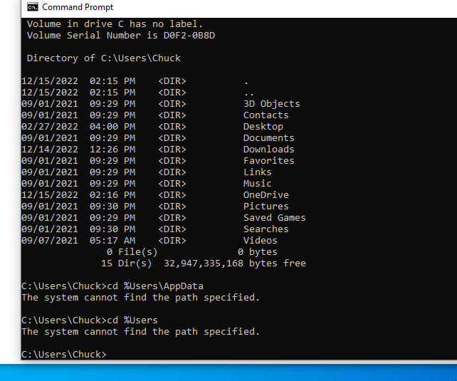

Point me to where the default locations are please ? %APPDATA doesn’t seem to exist from the command line (or I’m driving the wrong end of the bus) nor can I find the Plex executables . LOL
I have mine in a custom place, but I think default is in %Users\AppData\Local\Plex\Data\Plex Media Server\Plug-in Support\Databases.
Welcome to Windows! :stuck_out_tongue:
Type %LOCALAPPDATA% in an Explorer location bar. There’s a Plex Media Server directory in there.
It’s usually C:\Users\[username]\AppData\Local.
Windows does this hologram insanity with Program Files vs. Program Files (x86). The amount of backwards compatibility built into Windows is really stunning. Try %ProgramFiles%.
Is this what you guys feel like when I talk Linux?
:scream:
lol
Screenshot from 2022-12-15 14-36-35
AppData is hidden by default.
there is no %users either :stuck_out_tongue:
Typo, but you’re already in USERS :slight_smile:
Are you really entirely new to Windows?? How is that possible? lol
OK… I found the DB.
