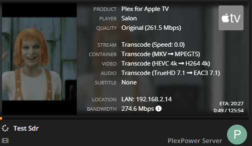

Test 1
Audio: TRUEHD 7.1
Subtitle: PGS
Result: Crash. He don’t like TrueHD
Dec 22, 2018 18:26:16.595 [13680] Error — [Transcoder] [h264_nvenc @ 04ce1740] InitializeEncoder failed: invalid param (8)
Dec 22, 2018 18:26:16.617 [5676] Error — [Transcoder] Error initializing output stream 0:0 – Error while opening encoder for output stream #0:0 - maybe incorrect parameters such as bit_rate, rate, width or height
Dec 22, 2018 18:26:18.703 [5676] Error — [Transcoder] Video encoding failed
1
