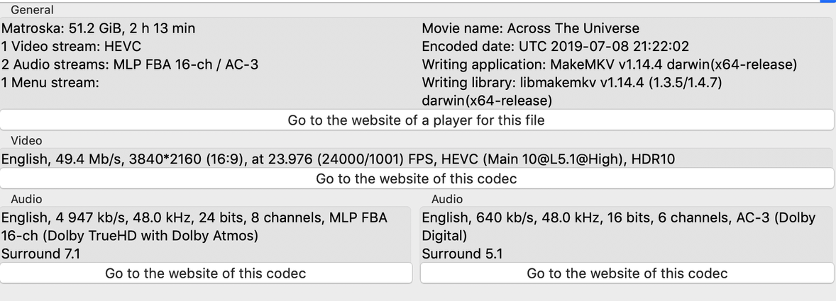

So I’m trying to figure out why a certain file that seems to meet the right criteria is transcoding instead of direct playing.

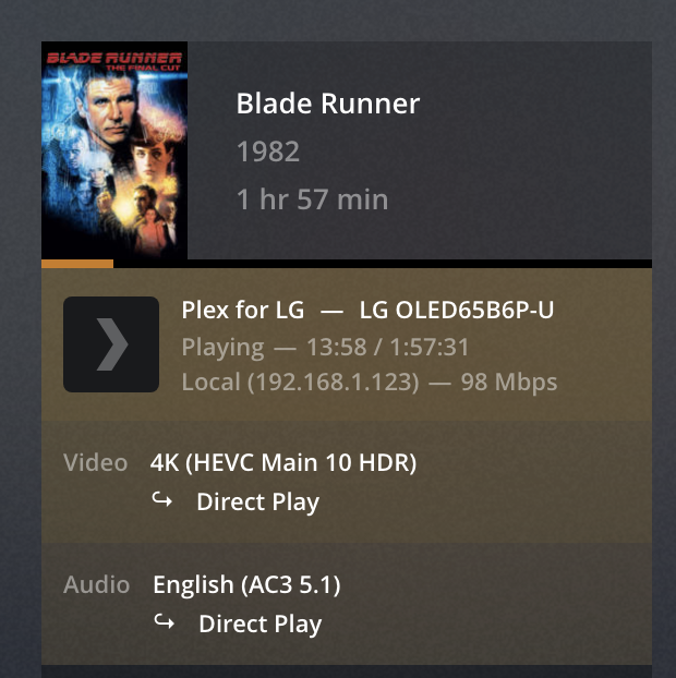

So here’s the details of the file from the Plex dashboard during playback along with an example file that plays back just fine. You can see both show the same video format (4k HEVC with HDR10), the same audio format (AC3 5.1) and doesn’t contain subtitles.

In this case definitely not a data rate issue as you can see in the example above that does play back correctly actually has a data rate almost 2x higher.

Full mediainfo and ffmpeg analysis.
If it’s an actual rip (which you did), and giving you this much trouble, then do it again because the file is damaged.
If it’s a “rip” someone else did, and it’s not full sized file, then it’s been processed. Time to dump it and replace it.
ffmpeg -i filename will tell you everything FFMPEG sees. If it’s been encoded by anything except the studio, you will see the metadata / writing signatures.
Hi Chuck-
By rip I didn’t mean that it is converted other than a full disc copy using MakeMKV. It hasn’t been transcoded at all. The file does playback if I use something like VLC on my desktop machine. It is definitely not damaged from what I can tell. And it’s not that the file can’t be played, it’s that Plex is transcoding it instead of playing it direct.
Here’s the details from Mediainfo

Ok, here’s the file info. across-the-universe-info.txt (12.1 KB)
<Part accessible="1" exists="1" id="99585" key="/library/parts/99585/1562623383/file.mkv" duration="7997990" file="/volume1/video/4k/Across The Universe.mkv" size="54956010372" container="mkv" deepAnalysisVersion="3" requiredBandwidths="97614,91862,83230,76098,70050,67976,64633,61048" videoProfile="main 10">
<Stream id="247868" streamType="1" codec="hevc" index="0" bitrate="54330" language="English" languageCode="eng" bitDepth="10" chromaSubsampling="4:2:0" colorPrimaries="bt2020" colorRange="tv" colorSpace="bt2020nc" colorTrc="smpte2084" frameRate="23.976" height="2160" level="153" profile="main 10" refFrames="1" requiredBandwidths="90093,84315,75587,68486,64505,62388,58693,55089" width="3840" displayTitle="4K (HEVC Main 10 HDR)" />
<Stream id="247869" streamType="2" default="1" codec="truehd" index="1" channels="8" language="English" languageCode="eng" audioChannelLayout="7.1" bitDepth="24" requiredBandwidths="6750,6443,6129,5775,5454,5259,5185,5185" samplingRate="48000" title="Surround 7.1" displayTitle="English (TRUEHD 7.1)" />
<Stream id="247870" streamType="2" selected="1" codec="ac3" index="2" channels="6" bitrate="640" language="English" languageCode="eng" audioChannelLayout="5.1(side)" requiredBandwidths="640,640,640,640,640,640,640,640" samplingRate="48000" title="Surround 5.1" displayTitle="English (AC3 5.1)" />
</Part>

Just as a comparison, here’s an example of a 4k file that plays fine that has the same track order for the audio streams. blade-runner-info.txt (9.0 KB)
