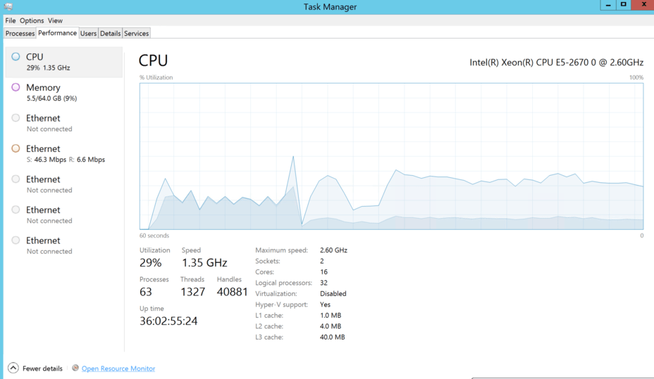

Can you start a transode of a single 1080 and then a single 4K and see what your CPU usage looks like?

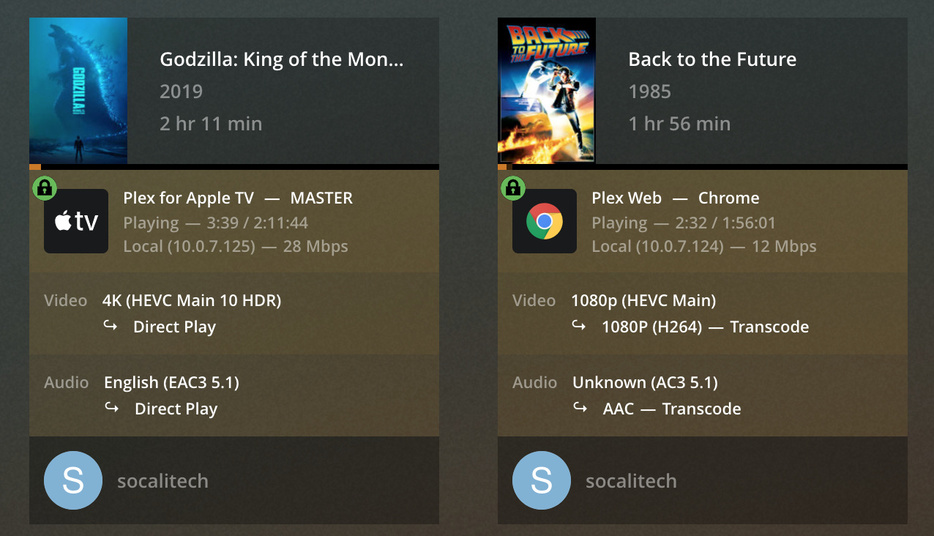

sorry for the delay, He is on windows 10 machine , this is playing one 4 k movie and 1080.

The 4K is direct play in that instance, not transcoded. See how much of a difference it makes on CPU usage when you transcode the 4K file or both.
